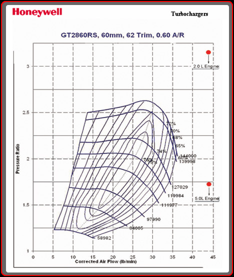

Simple answer, if you want more hp, fit a bigger turbo. You can see at the top of the map the turbo doesn't really hold much above 1.5Bar (Minus 1.0Bar of the Y-Axis to get the turbo boost pressure). At a certain point in the rev range it might get to 1.7bar but will then get breathless. This is not how you use a compressor map properly but it gives a good guide.
Also, if you have a 2.2Bar stroker kit then it will generate higher hp at a lower boost pressure anyway.
On that turbo you will struggle to get past 360hp at whatever boost/cams you run. Again this isn't high you use a compressor map but look at the far right of the flow, multiple it by 10 and that gives a reasonable maximum for the achievable hp.
Garrett show all the maths on their website but it gets complicated quickly.
Quite a few people on here are downsizing their turbos to make their car more responsive on the street and track. Having a stroker with a small turbo will make the car very responsive which some will like but if you don't then fit a bigger turbo. Personally I wouldn't bother overboosting the turbo as it gives a spikey power delivery like a diesel where you get a big shove followed by a breathless feeling. So either turn your boost down, be happy with what you've got or fit a bigger turbo.
