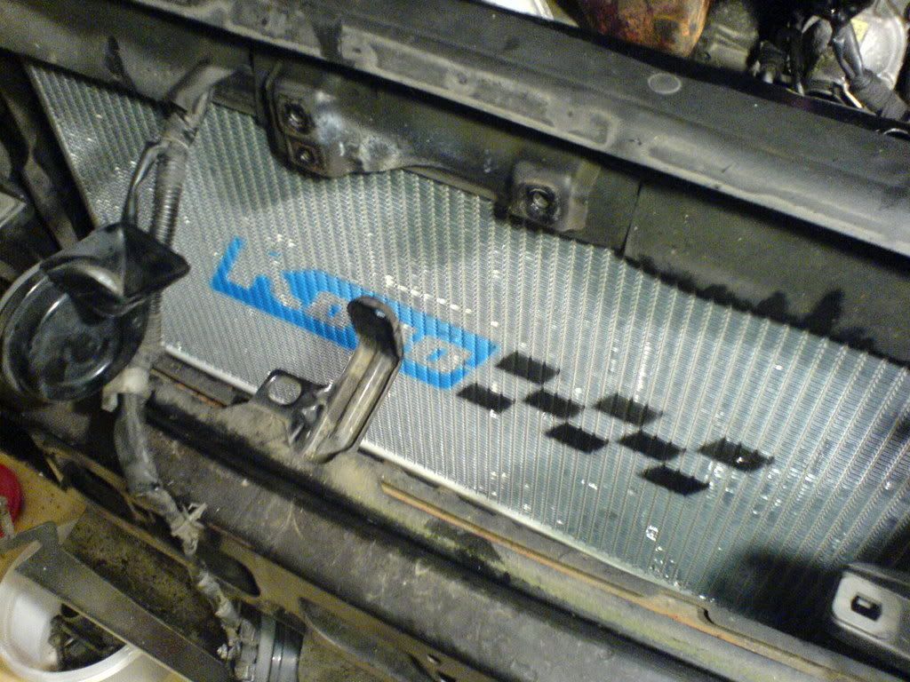

hi , im looking at getting absolute radiators twin core 53 mm rad with slimline fans , anyone running this rad ? i need to know before ordering that it will fit ..
ive still got my air con , and have a 3071 .. my tuner seems to think it ll fit with the slimline fans .. i just wanna make sure before i buy .. would like to keep the air con if poss .. cheers
Braveheart
I have a 53mm koyo rad fitted.
It was a direct fit onto the OE rad mounts but I do not have aircon and could only fit one OE fan back on due to lack of space. The cooling properties are amazing. I've had two track days with it and the temp stays down. I use to loose a lot of water out the expansion bottle with the OE rad but not a drop now.

im gonna call in the morning and order one , if the air con has to go , it ll go .. cheers for the info guys and braveheart cheers for the time taken to post pics mate , very much appreciated
