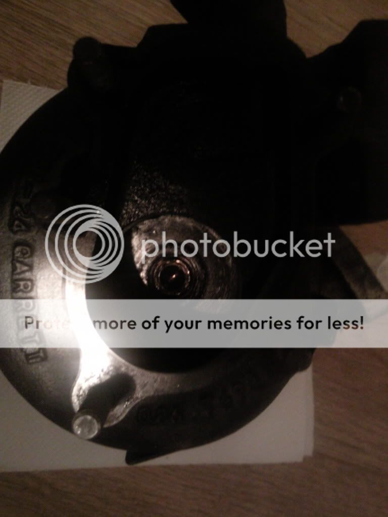

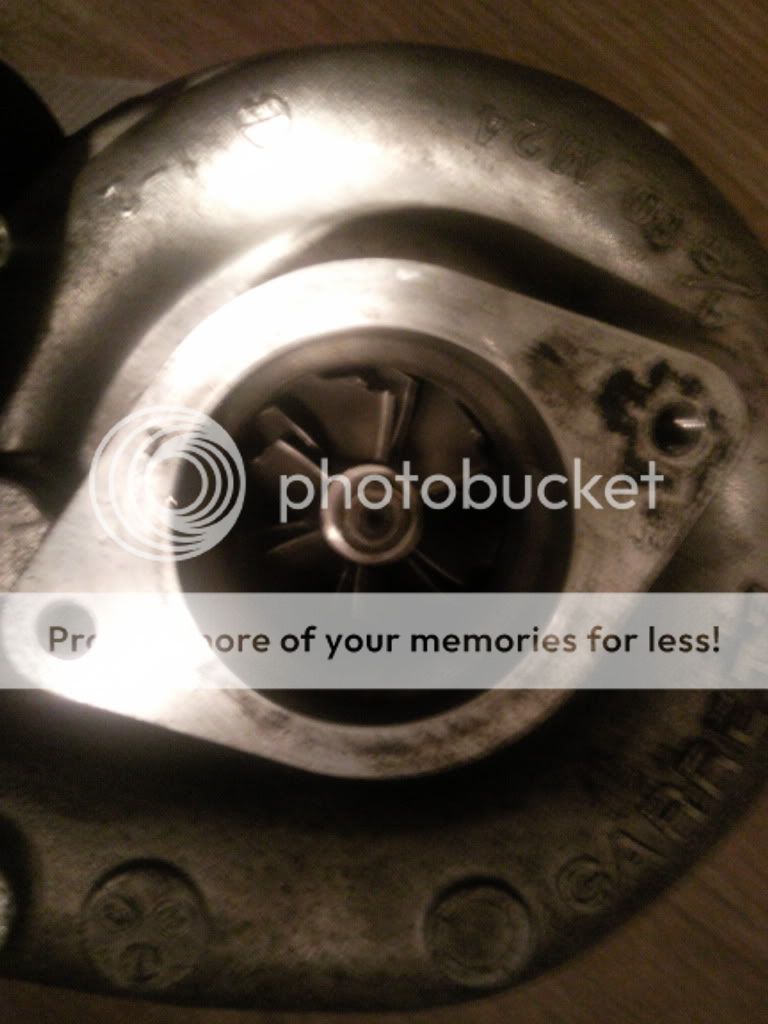

A few pics of my f**ked turbo. OOPS...
Gaz gtiR
No rear exhaust wheel?? prob in the exhaust somewhere?? :doh:
front compressor wheel smashed to bits. think i better check intercooler for bits of blades. :roll:

The front fins probably got damaged with the movement from whatever hit the exhaust.
Wow that is amazing, there is basically nothing left of the wheel.

my guess is as good as urs?? lol the rear wheel has just collapsed & disapeard? lol eather in my exhaust or in whoevas windscreen that was behind me? lol
What's your compression like?Something might have broken off in the cylinder and gone through the exhaust valve taking out the turbine with it.

yep ill do a compression test. check sump for thrust bearing?? do you mean from the turbo?? how wud it of got in to the sump? it wud of hit intercooler first wouldnt it?? :S
gtirx2
Yep through the oil return pipe on the block from the bottom of the turbo.
I had a thrust bearing once breck up and kill the blades on the turbo like yours, but not as bad.

ahh rite ill have to check that out. thanks for the advise. just hope its nothin broke in the cylinder n gone threw the exhuast like skiddusmarkus says? :eek:
