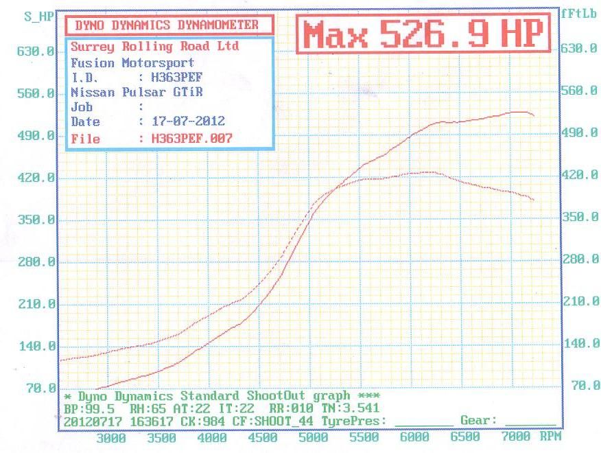

Big thanks to Ed on this. He has spent a lot of his time on getting the car right and I'm really pleased with the results.
Fuelling was maxing out and I need a bigger waste gate before pushing any further. No nitrous yet.
we made nearly 30 bhp extra at .1 bar lower using the syvecs and the Fusion coil pack over the apexi and power delivery comes in a lot sooner which is great.
I've compared this graph to the previous one and its amazing the difference the syvecs makes over the apexi.
torque is also up to 460 - 465 lbs ft which is good.
also thanks to Will for sorting out the bodywork. Great job.
Nice work and great results. Ed when you say new one? Is that new Gti-r record for you? What did Danny's (Red) make?

Funny thing is you have got the same gains as me from the same things...ecu and coil on plug...wait till you drive it the throttle becomes a torque controller and makes the car so much easier, eds getting panicky with pushing mine any further as I am still using standard conrods,

Around 580-610 will be 1.9 ish bar and 8k rpm, boost pressure is not flow, and the syvecs is allowing proper ignition control and that is where the power is coming from, ed was mapping mine a bit more last night and we have added more boost and more ign timing...and that is more power.
