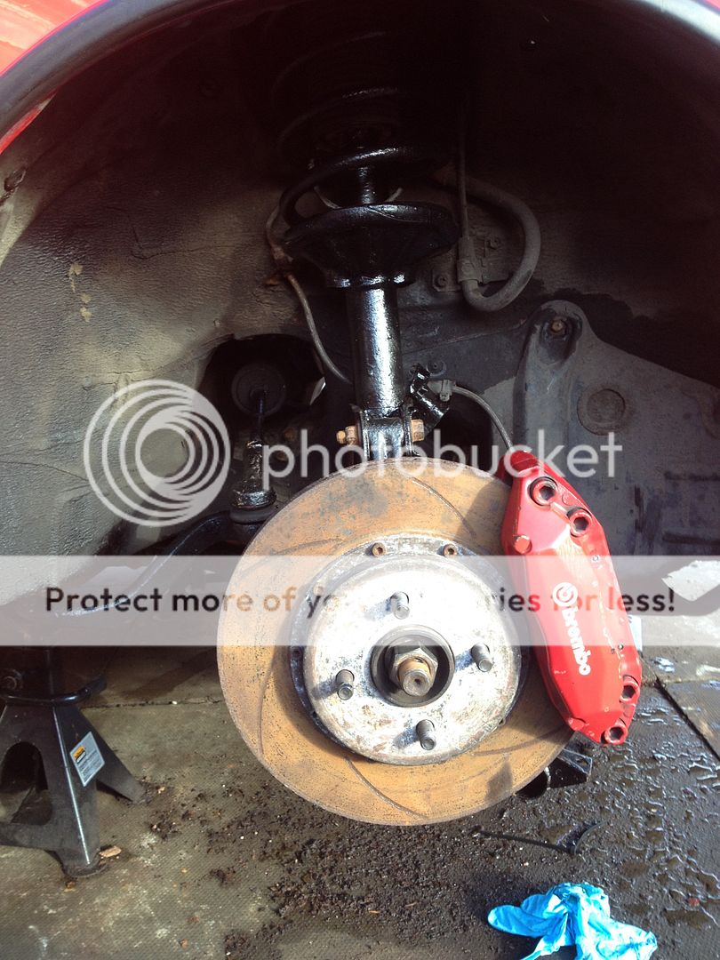

Superduck
I do not rated the wilwoods.
if you don't go for the brembos then you could think of the early evo caliper and Clio disc set up, work great and cheap.
They're also sold as a kit, ready to fit; no dicking around making-up brackets and spacing discs out.
