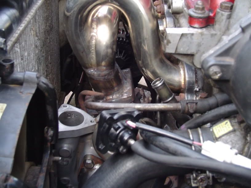

Manifold is good quality id say the welds are good on the in/outside it is a direct fit for the std position with a 3071 2 3/4 inlet will not fit with 4" , they were a very good company to deal with they even phoned me up to let me know it would be late getting ready because they were off somewhere and were snowed under with work to do.
I think the manifold was suppose to be a week but took 2 because of above.
I can get some pics soon as its all getting attatched to my new engine next weekend so ill take some close ups if you want, these are all the photos i have at the moment.
