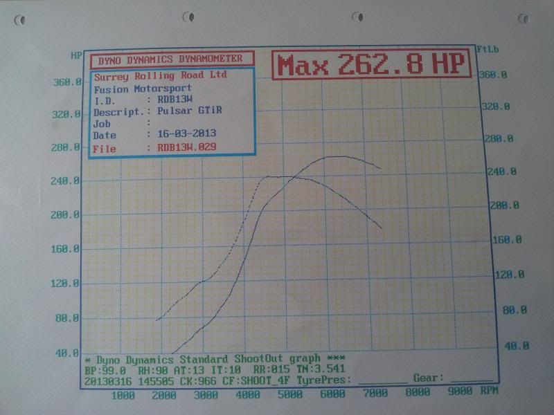

Went to see Ed yesterday @ fusion .. Last time on rollers with DP motorsport it managed 256 bhp @ 1.45 bar at the wheels ...
It was massivly overfueling all over the map.

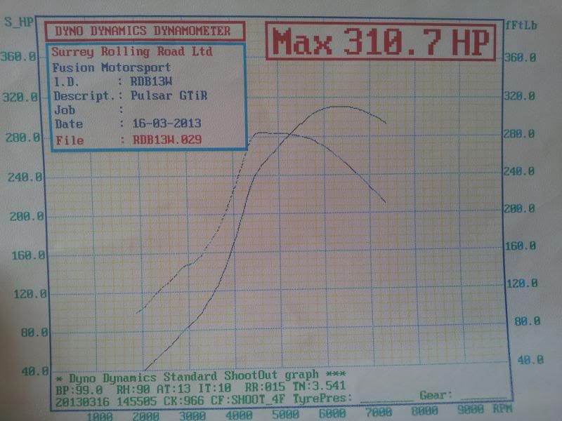

Now with a few extra mods and Ed tweaking the map it got 262 bhp @ 1 bar... works out at 310.7 @ the flywheel . And 285ft lb... Made up that I've got more power for less boost
. Must be the extra flowing exhaust and generally my skills under the bonnet. Lol

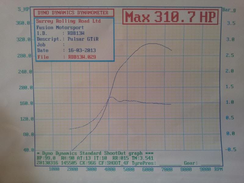

Ed reckons that either the turbo is on it's limits or the actuator is weak
.. I'd already told him that i wanted it safe and that im not looking for max power ..
It actually peaks at 1.2 bar but levels out at 1bar and when max power is reached it's at 1bar.

You've got very low transmission losses. It works out at 15.5%
My 268bhp worked out at 339bhp on the same rollers. Which is 21%

Why would it have low transmission loss?
last time it was on the rollers it was 256 at wheels and 325 at fly . Very confusing these Rolling roads.

Ed, why are his transmission losses so low? Thats about rwd territory.
Fusion Ed
I've just realised why - on the graphs it shows the shootout mode is wrong. It should be Shoot_44, not Shoot_4F. So the flywheel figures are well under. That car is in reality more like 330+hp @ fly, but wheels will be correct. Operator error, had a Micra on the dyno before this one, and I'm guessing Mark (not Charlie running it then) forgot to change it to Shoot_44, I didn't notice at the time either.

yeah if it's making 330 ish on 1 bar im well happy ..
thats more than it had last time with alot less boost .
Whats the most you've seen at 1bar on a standard turbo
that truly is unbelievable power on a stock tubby at 1bar:shock: most make between 290-310bhp
a 2871 would struggle to make that at same boost level (think mine made 358 @ 1.5bar)
