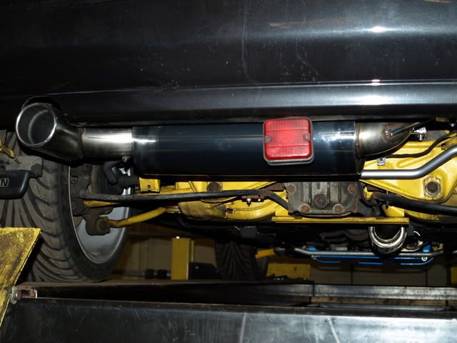

vpulsar
I had a custom 3" system made that was very quiet at normal driving speeds and track day friendly, And even with the big box at the back the car still made over 500 bhp so loads of noise doesn't mean loads of power.
John
williams
is that the cusco 4 point brace? was worried i wouldnt have enough room for the 3" system and the cusco brace.
