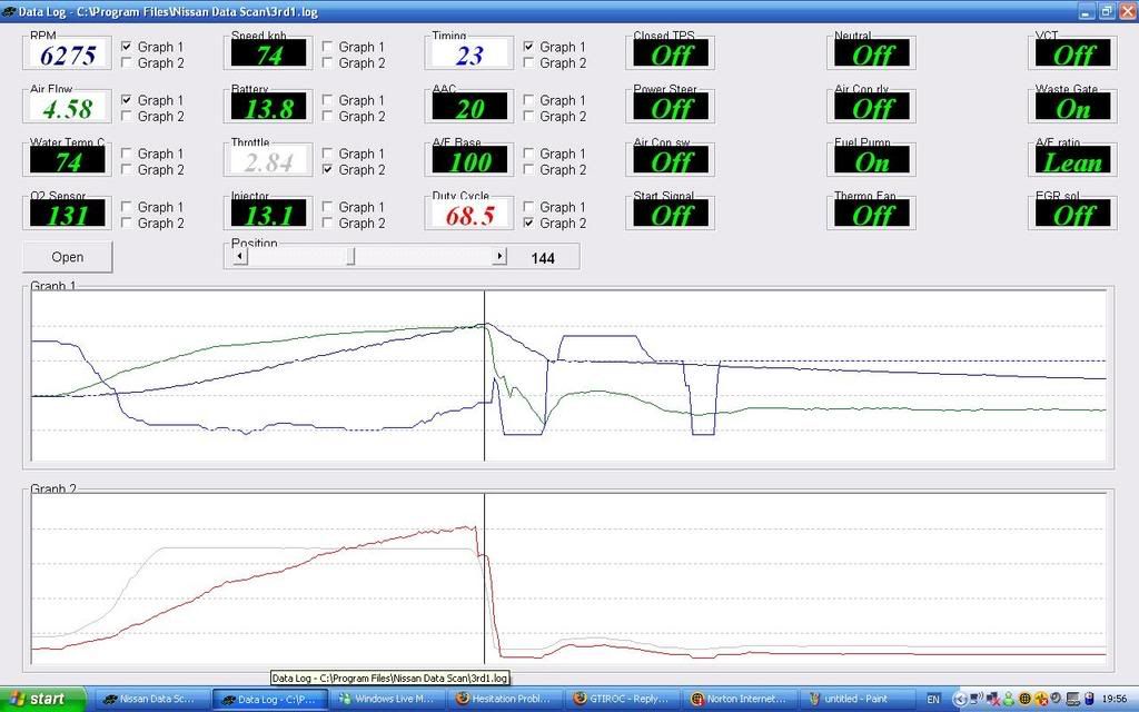

Update With Datascan Graph

here below is a 3rd gear pull i did down the private runway tonight!!
i notice that the timing is altering throughout the rev range. the timing fluctuates between 10 lowest and 23 at the highest (around 6.2k when i let off). is this normal?
